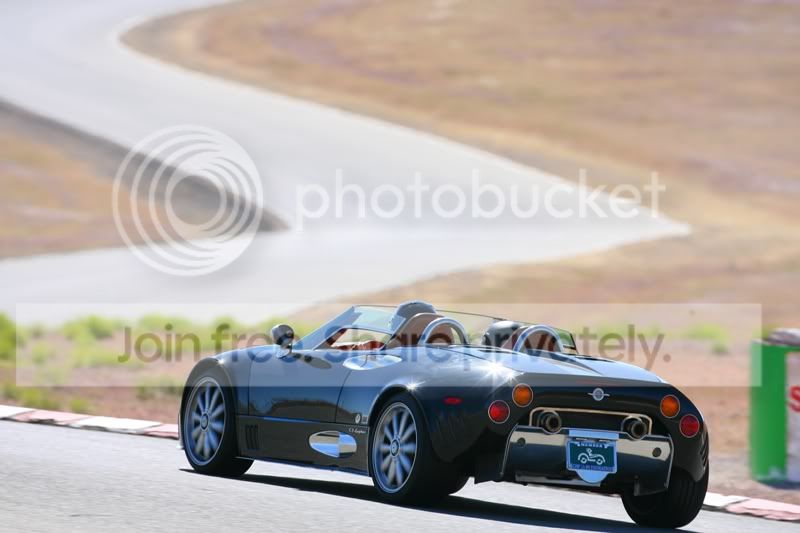

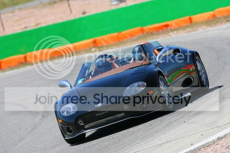

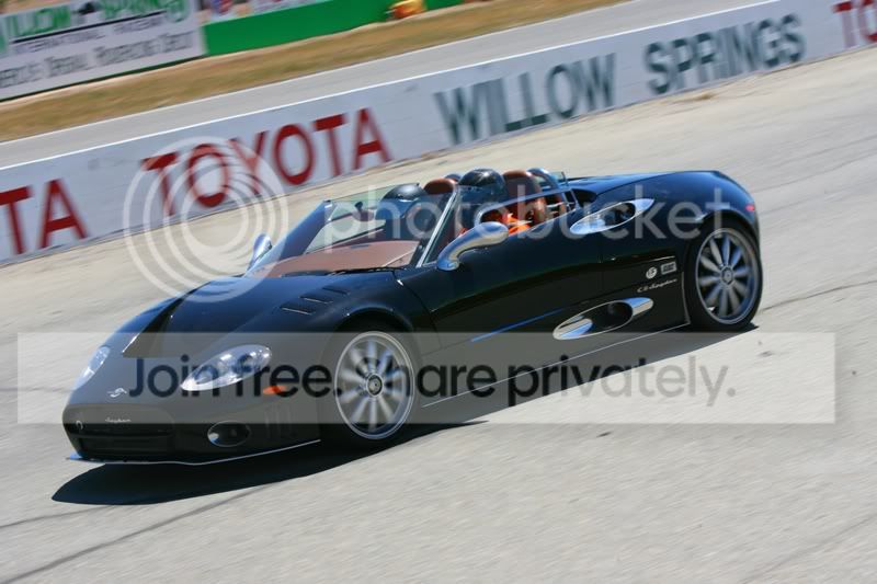

    Here are pictures taken at the May 12 tests at Willow Springs

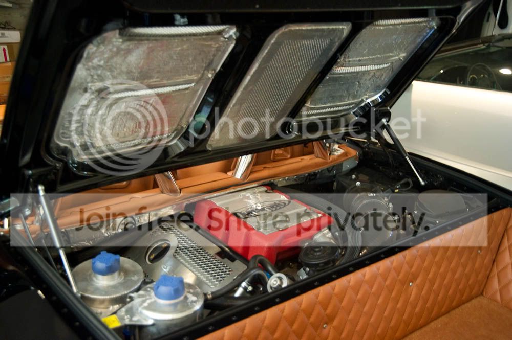

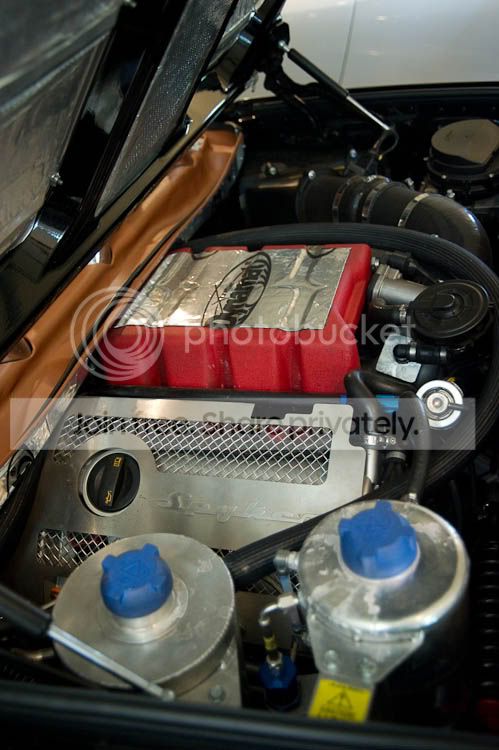

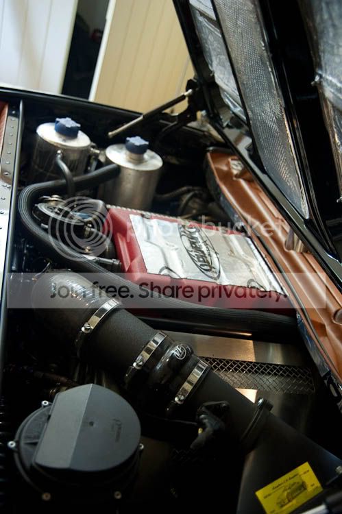

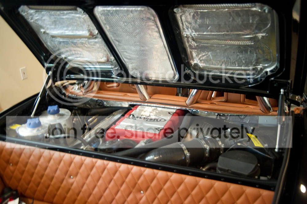

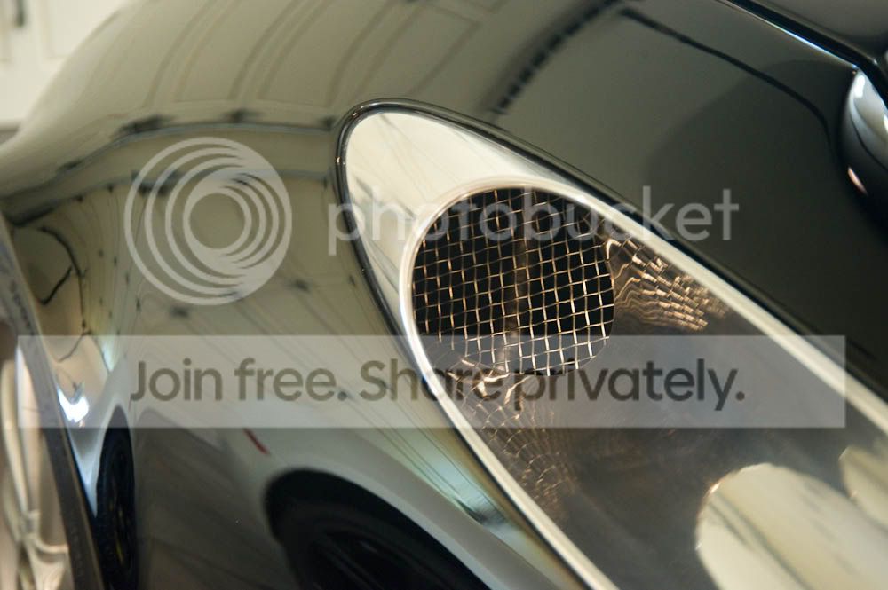

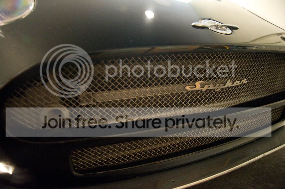

      Here are pictures showing the supercharger installation

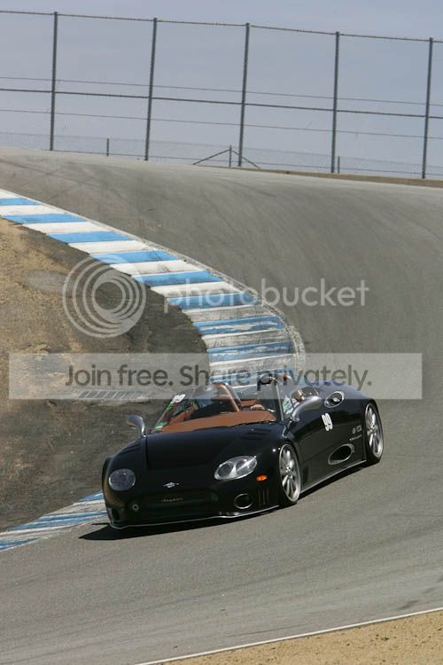

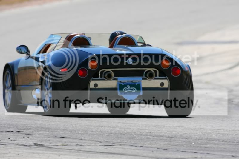

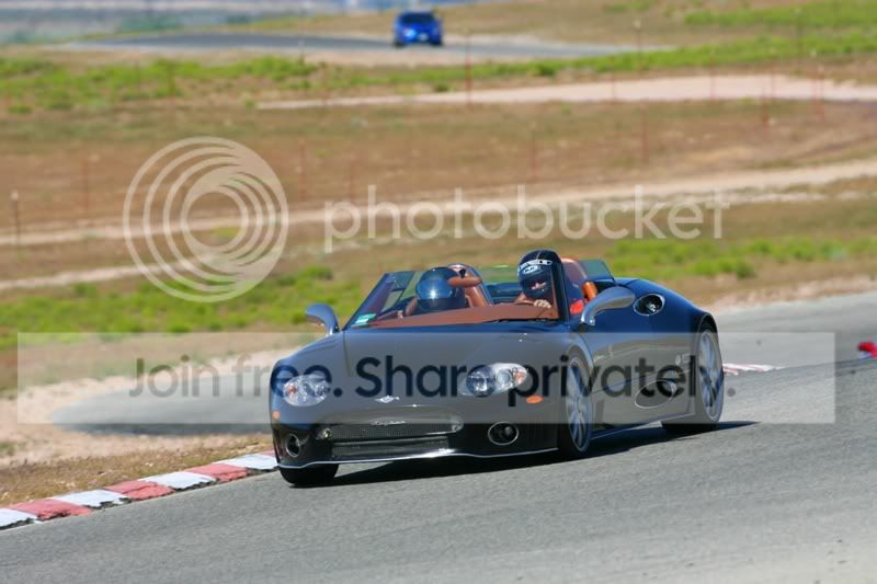

        These pictures were taken June 1 at Mazda Raceway at Laguna Seca, during the final testing of the supercharger installation

                        The air intake was modified internally to accomodate the new manifold, but it is otherwise the same diameter as the old, leading to the same aperture behind the passenger, high on the side.
                        The car now has three radiators at the front, where before it had two. So it goes (front to back): charge cooler, air conditioner, engine radiator.
